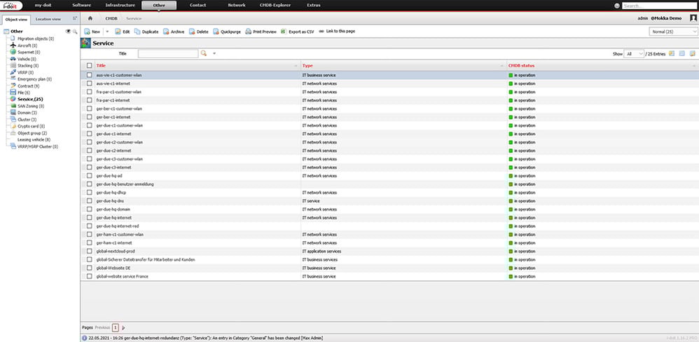

i-doit has a preconfigured object type for modelling services. To create a new service now, simply open the already pre-defined object type “Services” and create a new object.
jdisc-und-i-doit-en-add-service-1

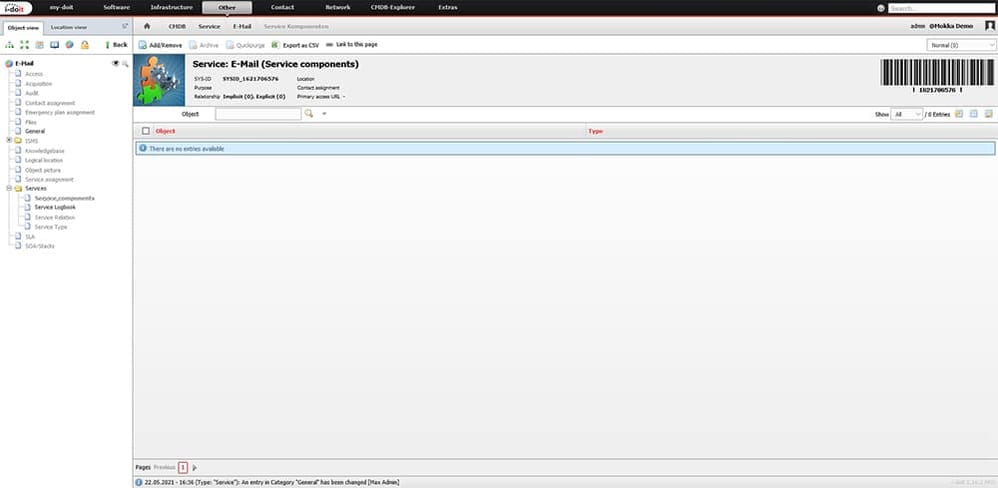

After assigning a name for the service you want to create, such as “Email”, the respective components are added in the “Service” folder.
jdisc-und-i-doit-services-als-objekte-anlegenServices can be created as objects in i-doit just like any other assets.
jdisc-und-i-doit-en-add-components-3After creation, various components can be added to the service.

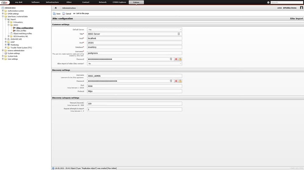

A secure VPN connection would place an additional load on the network. You can get around this by installing and configuring another JDisc instance in the location. This instance only scans the networks at the site. It then sends the results to the central i-doit instance. There, the data is merged. This way, even complex networks can be captured and summarised in a central CMDB.
jdisc-und-i-doit-en-jdisc-configuration-4
The respective JDisc server instances can be added in i-doit and used individually for importing data.

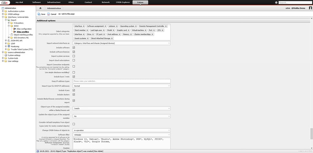

jdisc-und-i-doit-en-additional-options-5

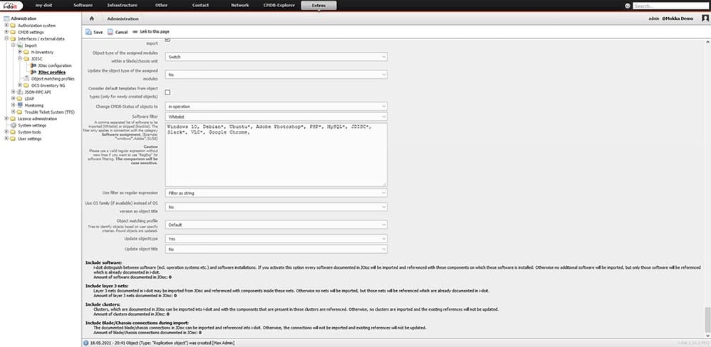

The device classes to be imported are configured via these profiles. Likewise, the information to be imported from these devices is defined here. This makes it possible to ensure a very granular import of data. By using different profiles, how up-to-date the data in the CMDB is can be perfectly controlled.
Selectively import or discard data
To make sense of the data received from JDisc, a selective import is recommended. JDisc detects every system service, every installed software and every application. That’s why the imported amount of data quickly becomes very large. Another problem: You fill your CMDB with information that you might not need at all. i-doit allows you to include and exclude information for import. This way you define exactly which data will be taken from JDisc and which will be excluded during the import.
jdisc-und-i-doit-en-jdisc-profile-6

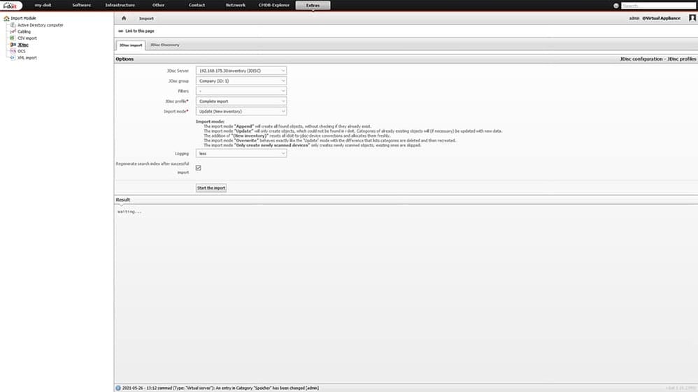

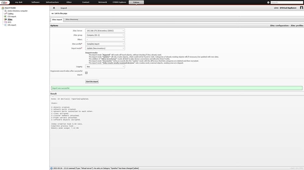

To start the import of assets, go to Tools -> CMDB -> Import. There you select the JDisc Import Module in the left navigation. Here we now select one of our previously configured JDisc servers.
jdisc-und-i-doit-en-import-7
Via the button “Start import process” a connection to the JDisc server will now be established. Afterwards the existing information will be compared with the data in the CMDB. Depending on the selected profile and mapping settings, new objects will be created, existing objects will be overwritten with information or completed.
jdisc-und-i-doit-en-add-import-complete-8

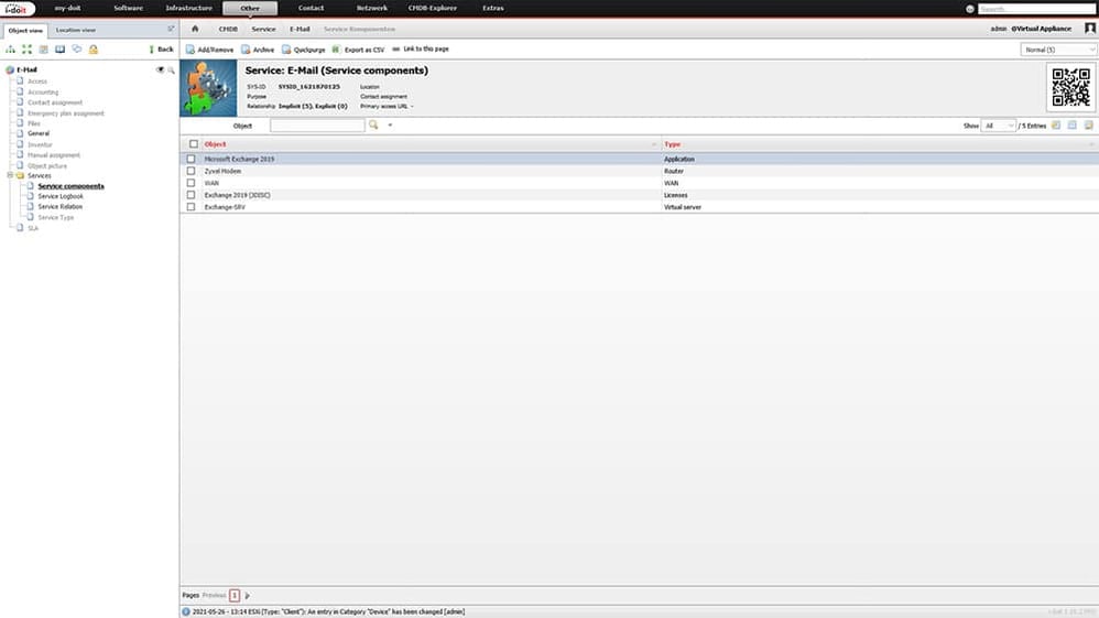

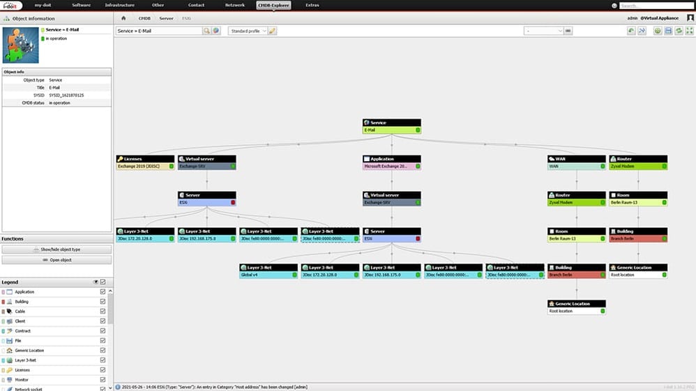

The assets that have now been imported can be used for modelling the services. To do this, we switch back to the created service object “Email” and add the necessary components. Our service “Email” consists of:
  • the virtual machine
  • the Exchange software
  • eExchange licence
  • the WAN line
  • the modem
jdisc-und-i-doit-en-jdisc-service-components-9

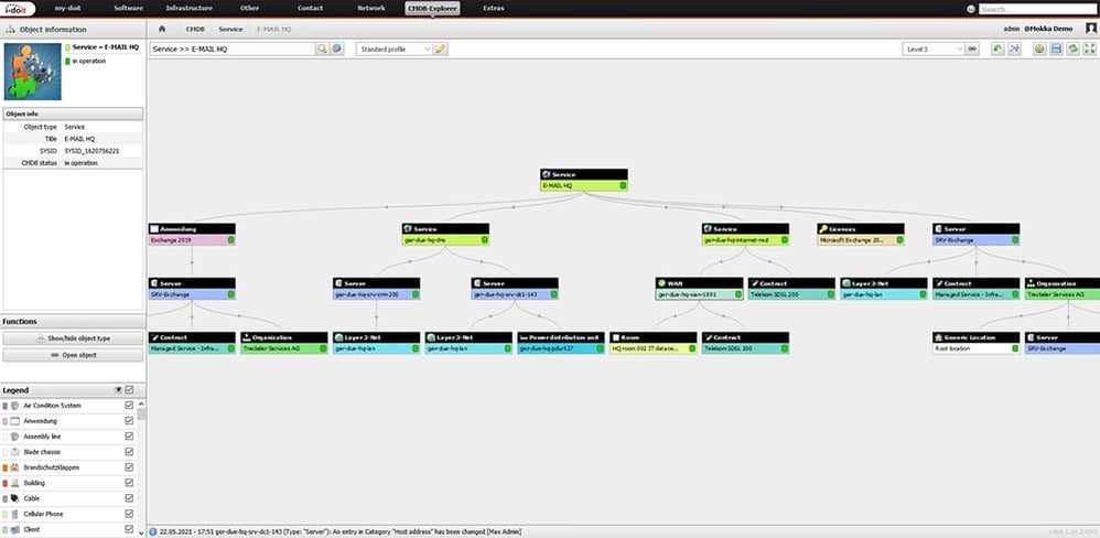

We can now open the service via the CMDB Explorer. There we check the dependencies and relationships between the assets. Not only the selected service components are displayed, but also the assets required for them, such as the physical EXSi server on which the Exchange virtual machine is run.
jdisc-und-i-doit-en-cmdb-explorer-10
If this now changes to the “faulty” state, we can see from the service view why the service email is currently faulty. If a fault is now reported, the responsible HelpDesk employee can call up the entire service in the CMDB Explorer. There they check whether one of the components is disrupted and if so, which one. This makes it easy to check the consistency of services.
jdisc-und-i-doit-en-cmdb-explorer-service-11By calling the service in the CMDB Explorer, all components and their status can be checked.
