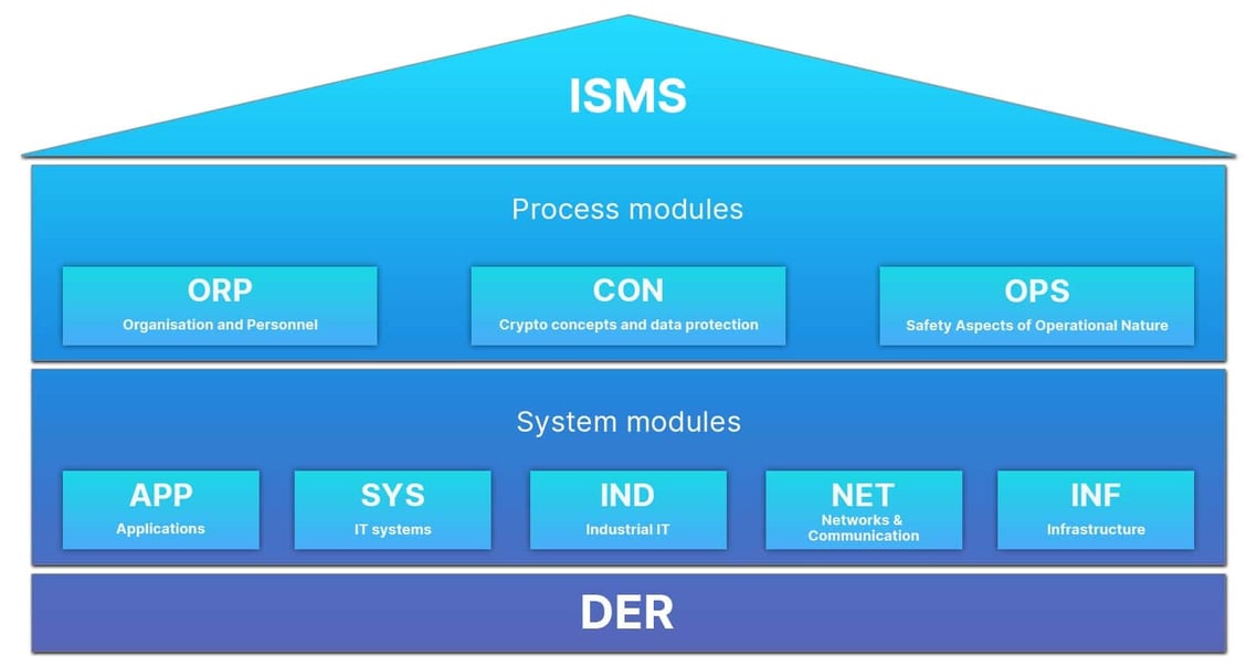

Achieving a high level of protection according to IT baseline protection is realised by implementing different layers and building blocks. Each building block represents a specific area of the organisation in which security measures are implemented.
layer-model
At the top of the layer model we find the ISMS. It monitors the other process and system modules through the defined organizational structure and the security process. It is therefore the basis for IT baseline protection. Below there are the process modules for ORP, CON and OPS.
  • ORP: Organisation and Personnel, e.g. sensitisation and training on information security, authorisation management, and induction for new employees.
  • CON: Crypto concepts and data protection, e.g. data backup concepts, deletion and destruction, software development.
  • OPS: Safety Aspects of Operational Nature (Operational), e.g. patch and change management, remote maintenance and logging.
Below this are the system modules. These deal with the systems used, communication paths and infrastructures. There are a total of 5 system modules for APP, SYS, IND, NET and INF.
  • APP: Applications, e.g. Office products, web servers, databases, directory services
  • SYS: IT systems, e.g. Windows Server, Linux / Unix Server, Virtualisations, Clients
  • IND: Industrial IT, e.g. process control and automation technology, sensors, machines
  • NET: Networks and Communication, e.g. routers and switches, firewalls, WLAN and LAN management
  • INF: Infrastructure, e.g. buildings, data centres and server rooms, home office / workplaces.
The last building block is Detection and Response (DER). Since this can extend to all other building blocks, as both systems and processes can be monitored, it independently forms the last level.
This module is responsible, for example, for the detection of security-relevant events, audits and revisions as well as the handling of security incidents.

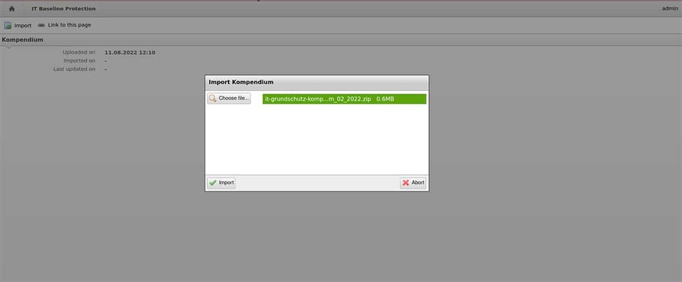

The IT baseline protection Compendium consists of numerous threats, requirements and measures to avert danger. This means it already contains all the information needed to achieve a high level of security. The entire IT baseline protection Compendium is available for you to download from the customer portal. You can import it into the CMDB with just one click to access all requirements and threats and assign them to your assets.
customer-portalThe IT baseline protection Compendium is available for download in the customer portal.
compendium-installThe IT baseline protection compendium can be imported directly into ViVA2 to gain access to all hazards and requirements.

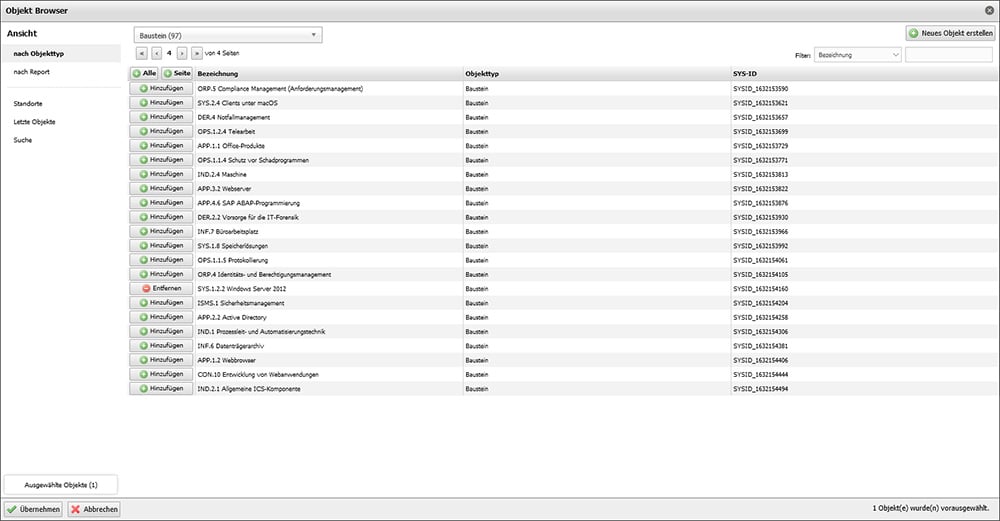

Selection of the process modules
Depending on which asset is being considered, various process modules from the IT baseline protection compendium can be added. From applications (APP) to systems (SYS) to infrastructure (INF) and detection (DER), all process building blocks can be selected.
prozessbausteine

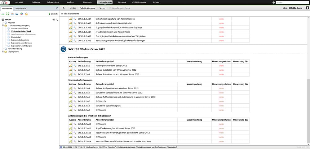

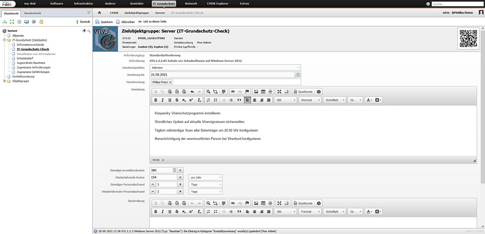

After selecting a module, the associated basic, standard and requirements with increased protection needs are automatically loaded in the category “IT baseline protection check”. Based on this overview, the implementation of the requirements can now be planned and controlled.
grundschutz-checkAll requirements of the selected building blocks are loaded automatically.
By processing the requirements, work steps can now be defined and delegated to responsible persons. In addition, the one-off and recurring efforts can be recorded.
umsetzung-grundschutz-anforderungThe implementation of the measures can be specified directly in the requirements of the building blocks.

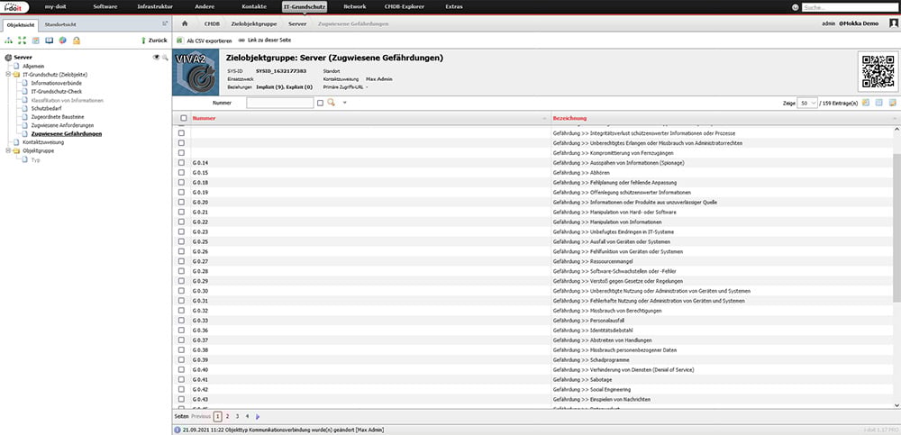

Adding the building blocks also automatically links the threats that have been defined by the BSI. This allows responsible persons and technical staff to determine exactly in which area you should take additional measures to achieve a higher level of protection.
uebersicht-gefaehrdungen
In addition to the defined threats of the IT baseline protection Compendium, the VIVA2 add-on also provides you with numerous additional threats with practical knowledge. In total, the VIVA2 add-on contains almost 600 threats that can be assigned to assets for risk analysis.

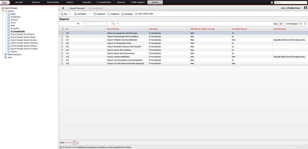

The data entered can be evaluated in various predefined reports. For example, each employee can list an overview of the requirements assigned to him or her in order to always have them in view. Applications that have not yet been installed or hardware that has not yet been assigned to a location can also be easily evaluated via the respective reports. In this way, specialists and managers can monitor the progress of the project at any time.
reports-it-grundschutzWith the reports provided, you can always keep an eye on the progress of the implementation.
Through regular evaluations, the progress of implementations can be constantly monitored. This also allows additional necessary measures to be identified in order to further increase the level of protection. In this way, you can achieve a continuous improvement of your information security standard.
